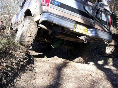

Here is what I'm using. It just slips into the reciever like a regular ball. So far I have only used it to recover other vehicles, never needed to be pulled from behind yet. Eventually, I plan to either build or buy a rear bumper/tire carier combo with tow points built in. But for now, this has worked pretty good for me.

Here is what I'm using. It just slips into the reciever like a regular ball. So far I have only used it to recover other vehicles, never needed to be pulled from behind yet. <snip>
Hey RoadKill,
THanks for taking your rig out onto a trail so that you can get me a great picture from underneath and behind.
