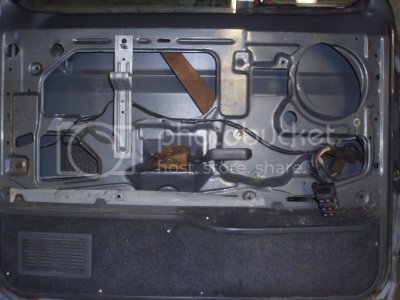

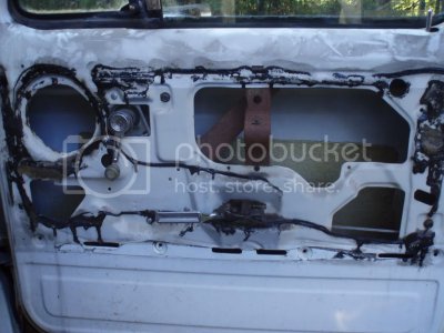

alright well i pulled panels off both my manual doors and power doors and was happy to find that they look identical. I dont think there is any issue with installing manual windows on a power window door. here are the pics so you can decide for yourself.
Power door of my 89
Manual door off my 85
