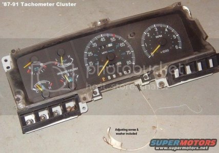

Have a problem with my Bronco. Coolingtemp goes up to about the "N" in NORMAL, but then it falls down and stays like the tempgauge in the picture.
Random picture!
