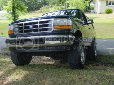

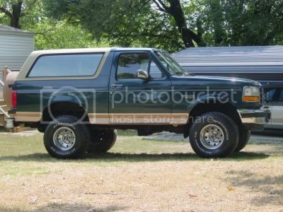

4" skyjacker suspension lift here with 33x12.50 bfg all-terrains. i could probably fit 35's but the 33's do pretty good.
