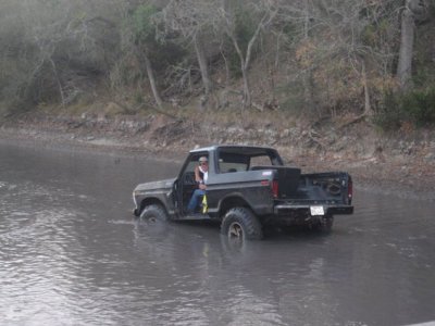

I'll show you a pick of my 78 which has the inner fenders removed. I got stuck in this pond not because of water in the motor, just too deep of a mud hole. I spun all four tires, turned the steering wheel lock to lock. I'd say you'll get more mud inside the cab with the doors removed, but even here i stayed fairly clean:
Here's the thread with more pics:
http://broncozone.com/forums/index.php?showtopic=12562
