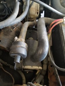

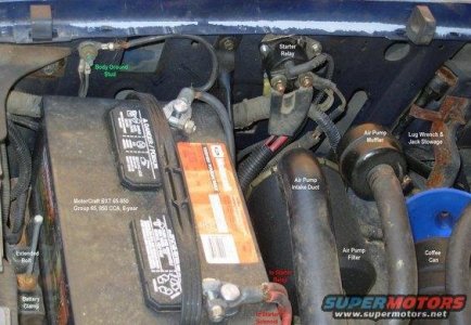

I have a 93 Bronco with a 351W/5.8L, E4OD transmission. The truck had been sitting since 2006 until I had a used engine swapped in a few months ago. At that time, I was told that the smog pump was seized up. Since the truck is too old for IL emissions testing, I replaced the pump with an idler pulley. The shop that installed the engine left most of the other emissions stuff in place, so I'm trying to figure out what else I can remove. Can I remove the coffee can looking canister on the passenger wheel well in the enclosed picture? What about the component in front of the canister that is in the second photo? Can I remove the catalytic converter? The O2 sensor is upstream from the catalytic converter, so I do not think it will be affected. Is there more stuff that I can / should remove.

Your 2nd pic is the smog pumps filter;
Filter Location pic in 92-96 by Steve
It can go along with the muffler or save to sell.
