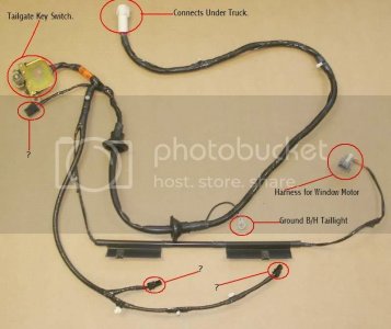

Could someone fill in the blanks on this harness?

I do not know but I'd like to take a guess. I had my harness out and I did not have these plugs, My guess is heated tailgate glass connections. Not sure about the larger one but the two smaller plugs would be my guess
Could someone fill in the blanks for this harness?
The one by the key switch is for the safety switch located in the left hand tail gate latch. The other two are for the rear window defroster element if you have one.
