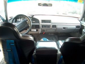

In this pic you can see how wide his CONSOLE is

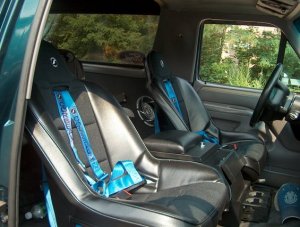

Corbeau in a 94
Source: by Haustkraft (Eleanor, Rob, The Green Macheen) at FSB

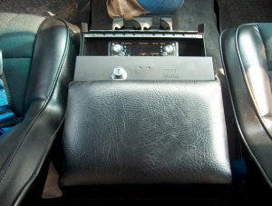

"Corbeau Baja SS Black w/ Cloth inserts. Corbeau Sliders, and a Tuffy Series II Stereo Console. The seats were a pretty basic install, eveything fit perfect. The Console was a little more work. I had to drill three holes to mount it to the floor, Cut a hole in the bottm (about 1") to send wires through to my amp, and then get on the ground and bolt it to the body with nuts and washers underneath. I then had to lenghten the factory radio harness about 2 1/2 feet, and slid my radio in. I got a factory Am/Fm Radio from the junkyard and put it back in the stock location, so when i lock the console and someone looks in, it looks as though I have a stock radio rockon.gif. SO whadda think?...
I ordered the seats, sliders and console all from JBG. The total was $808. These seats feel frikken awesome! They are so much better than the junk stocker seats. There is no side to side movement, and you dont go anywhere, a much safer feel. I would suggest these seats to anyone! These seats compared to beard are pretty close the beard seats are about the same fel, maybe a little better fabric on the beards, but the beards are about $100 more a seat when getting shipping and Bronco Sliders....
