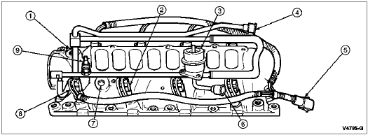

IAT Sensor Location
(5.8L
(Part of 9424)
Lower Intake Manifold
Item Part Number Description 1 — ECT Sensor Location
(Part of 9424)
2 9F593 Fuel Injector
3 9C968 Fuel Pressure Regulator
4 9D280 Fuel Injection Supply Manifold
5 9D930 Fuel Charging Wiring
6 Fuel Return Tube (Part of 9F792 Assembly)
7 IAT Sensor Location 5.8L (Part of 9424)
8 Water Temperature Sender Location (Part of 9424)
9  FuelPressure Relief Valve (Part of 9F792)
25,127
