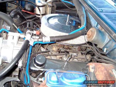

This is an old pic, prior to the shaker kit, but may give you an incentive. I got me some chrome valve covers, and the breather cap is where I put the oil in.

thanks a lot for the advice. the pic helped out a lot. u have a new ac system? looks like a new freon tank thing, o and i like the blue cover for the brake fluid. so are new valve cover gaskets something i can do on my own or should i take it in. i dont have many tools at all at my disposal.
so i can just unscrew the yellow cap on the valve cover and just poor oil into the engine that way?
one more question, just curious, whats all the blue tubing u have running around in your engine?

Where do I begin? You can easily change valve cover gaskets, if you need help just e-mail me. You don't have to get new chrome covers, I did that because the old ones were rusted out.
Yes, just unscrew the yellow cap and pour the oil in the opening in the valve cover. I still use a funnel, but it's much easier than filling thru the dipstick.
I have converted from R-12 to R-134a on my AC system, but all of the components are stock and original. They look so shiny new due to cleaning with "Scrubbing Bubbles" bathroom cleaner.
The blue tubing is simply blue wire looms that I bought at a car&truck show. You cna order those in any color from J.C.Whitney, Summit. or directly from Taylor Co. You might also find thos at the local parts store.
FYI, that pic is 3 yrs old, so I have more stuff added on. Things like the brake fluid cover I just painted to match my paint job. You see all of the rust on the brake booster, wiper motor, hood hinges, etc. and I spray painted little items like that, too. I am an engine freak, so every thing I can refresh, I've restored, replaced or repainted. It's alot cheaper than new chrome parts!!!
