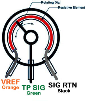

A weak ground connection can also cause the PCM’s internal reference voltage regulator to function incorrectly. This can be checked at the TPS by checking voltage between the black ground wire and the orange reference voltage wire.
http://www.supermotors.net/getfile/1047966/fullsize/tps-graphic-3.jpg
With the key on, this voltage signal should be somewhere between 4.7 V and 5.3 V.
