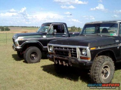

I've been debating this same issue with my 78 Bronco and 79 F-150 4x4. The 79 F-150 has a 3" Skyjacker sups kit + 3" body kit, and the 35" BFG's fit just right. The 78 Bronco has stock suspension and 3" trimmed out of the front fenders, running 38" TSL Super Swampers. the previous owner removed the 3" body lift before selling it to me, so I either had to cut the fenders or install a lift kit. I'll see if I have a sidexside pic of the two, JSM84
Something else on the body lifts. The rag joint on the steering shaft was totally shot on both rigs, due to the increased angle from the body lift. Also, there is no pre-made kit to re-locate the bumpers, since the front frame horns make it hard to do. I fabbed my own kit for the 79 F-150 to raise the front bumper up to match the body lines.
