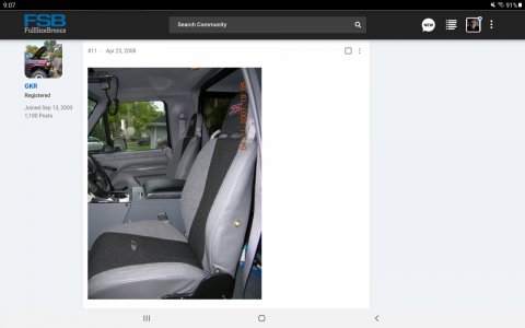

GKR has same seats; "I have the Mastercraft recliners and love them. I have arthritis in my lower back and the factory seats just agravated it. The Mastercrafts are more than worth the dough for me! Also use their tool bags and really like them.
Glad to hear you got such great customer service from the owner." READ more!

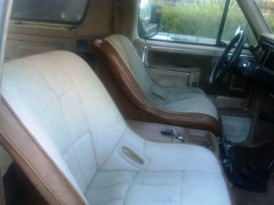

Beard Low Back pics in an 86
Source: by BajaBronco13 at http://www.supermotors.net/registry/17034/74400
