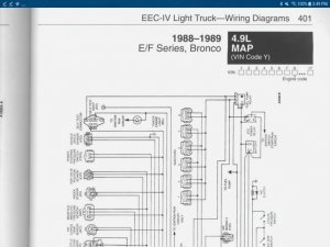

Still not running, ok I found the canister by the transfercase removed the large line coming from the tank and no fuel thru it when I cycle the key. Could there be a power issue, like I mentioned erlier I replaced the fuel relay and the high pressure pump started coming on. Are both pumps powered by the same relay, I believe they are. Any ideas, anyone thanks in advance.
