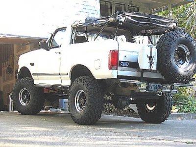

I know a couple of folks who keep their 37s back there. The DO make sure to take um off and put them in the bed when wheeling. If you are carefull with the swing you should be ok. I have a 32, high-lift, bike rack and or 5 gallons of gas on mine. bike rack and gas not at the same time. No issues yet. I even managed to almost rip the gas can off on a tree.
Here is a shot with the gas can holder it is a regular 5G gerry can,
Just realized the pic is of a 31, a 32 has riden back there a few times. Still need to get a real spare.

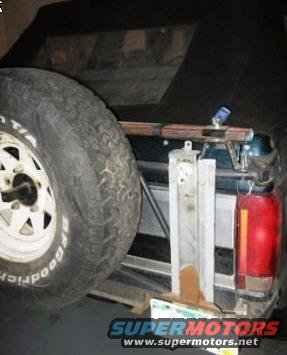

I am woking on a new bumper/ tire carier as you can see from the pic there is no bumper there now. I was not trying to advise that puttijng a 35 is great but that it certantly CAN be don with out damage. Just for point of referance.
Has been there for at least a couple of years.
