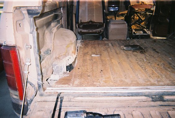

finnaly had some time to get some work done today and heres what I found seems that the area on the outside of the bed (not the corrogated part) has pretty much rotted out not the wheel wells surprisingly and the body mount are solid still as I thought but they still should be done not the greatest art work but best I can do without a cammera any one know where to get these panals (floor sections affected shown in red)Untitled.jpg
finnaly had some time to get some work done today and heres what I found seems that the area on the outside of the bed (not the corrogated part) has pretty much rotted out not the wheel wells surprisingly and the body mount are solid still as I thought but they still should be done not the greatest art work but best I can do without a cammera any one know where to get these panals (floor sections affected shown in red)View attachment 5083
yo!
Look here;
Jeff's Broncograveyard
and:
Mill Supply:
http://www.rustrepair.com/repair_panels/on...mp;p=sm-ford.pu
http://www.tri-proautomotive.com/servlet/t...onco/Categories
http://www.autostyles.com/bpbronco8096.htm
