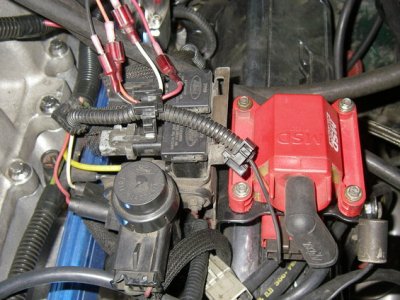

Hey fellas,
Hey im trying to find out what a small Vacuum line on an 88 Bronco w/351 that is broken off goes to, so i can put it back on. It is a small yellow line that on one end goes to some kind of sensor (on the driver side) then it runs behind the throttle body and comes out on other side and that is where it is broken off at. There is also the same size lines that are green tan and i think red they are all the same and all generaly tie in at the same area (on the driver side above the steering shaft) all the other lines are hooked up except the broken yellow line. I have one other small line that is broken off and it is a black like the same size as the other ones i mentioned and it is easy to see as it connects to a T connection abover the passenger valve cover the back of the T is good and so is the side that goes towards the passenger side but the line that comes out going toward driver side is broken off and i cant find where it is supposed to be, when i pulled it out it was running under the throttle body. If anyone can help me out with where these lines goes it would be much appriciated.

the Yellow Vacuum Line goes from the TAD Solenoid (driver's side forward solenoid) to the TAD (Diverter) Valve located at the rear of the Intake Manifold. You have to climb up onto the engine to feel the Diverter Valve or remove the Intake Manifold
Also see Secondary Air Injection system

Black = Vacuum Reservoir Can (Tank) (VRESER) to TAD & TAB
Red = Main vacuum from Intake Manifold to Vacuum Reservoir Can (Tank) (VRESER)
Yellow = from TAD to Combined Bypass and Diverter Valve. located at the rear of the Intake Manifold
Pink = from TAB to Combined Bypass and Diverter Valve (se Seattle FSB info below)
"...The Pink Vacuum Line goes from the TAB Solenoid (driver's side rear solenoid) to the passenger side (adjacent to the Vacuum Reservoir Can) and down to the bottom of the TAB (Bypass) Valve. Note that my Pink Vacuum line appears Yellowish in this pic and is not yet connected to the base of the TAB Valve as I was working up a solution at the time.
