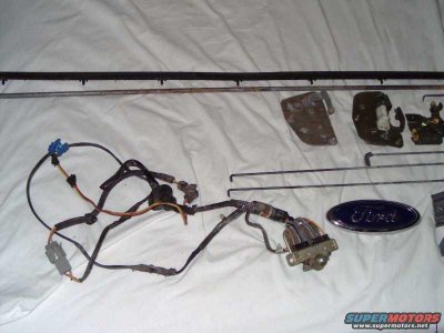

The wiring harness for the tailgate runs from the key switch on the tg driver's side to the window motor in the tg center, You find the connector from the motor and unplug it, then jump to the motor-side of the connector. In the pic, the gray connector is the one I'm talking about. Someone had cut the wires to the motor, then installed a blue splice connector
Right, you are bypassing the short circuit or faulty switch in the system between the regular battery in the engine bay and the motor for the window. Jumping simply means directly applying 12V battery power to the motor, or any accsessory you do this to, for only a brief period of time. You don't want to leave it hooked up this way, because you can burn out the motor or possibly have an electrical fire without the proper protection from the fuses and switches in the system. If you jumper the motor and the glqass does not go down, just try reversing the wires (+ and -). If that doesn't work, or you don't get the motor to run, then it is already burned out. If it runs but the glass won't move, then the motor gear is stripped.
