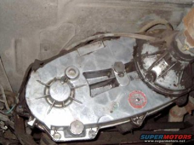

Crawl under the Bronco, and look for any kind of ID tag or label on the t-case. The 85 most likely will have a NewProcess 208, which has a red sun label. The back of the case is smooth. IF it's got lots of little fins/ribs, then it's a Borg-Warner 13-45. JSM84
Pic of NP208:
