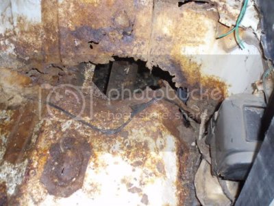

i havent found a patch for that area yet or at least not one thats listed well. I think the best bet is either find a truck in the junk yard that hasnt rotted through and have someone there cut it out for you, or make it yourself.
i believe this is what your talking about

nope that pic is the corner just under the rear speakers just behind the drivers seat belt(in the pic). That little area holds water like theres no tomorrow.
That is the result of Ford's lousy splash guard design. If you look at the splash guard, it has a nice slot right up against the quarter panel. I think Ford designed it that way in order to cause the truck to rot out so you would have to buy a new truck,(the 5 year obsolescence plan). That causes mud and water to be thrown right into two places that are perfectly designed to hold it there, (1. between the quarter panel and the rear door post and 2. up on top of the rear cross member and just under the tail light.) In my last round of body work, I redesigned the splash guard to seal against both sides of the wheel well which keeps the crap out of those areas. It's one of those things Ford could have fixed but never chose to.
As far as that area goes, I don't know of anyone who offers preshaped replacement metal. It definitely needs to be completely cut out and replaced. As suggested, the easiest fix would be to find a truck with that are in tact and not rusted, cut more donor metal than you think you need, cut out the bad area, and fit the donor piece in. However, keep in mind, when you remove the obvious rust, you will most likely find other damage under it. It's not a real easy place to work in, but definitely doable.
