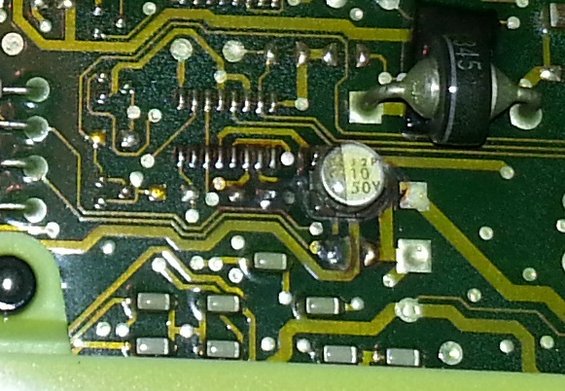

Capacitor Repair in a 90 5.8
Source: by seedpress (dolittle) at Ford Bronco Zone Forums
http://broncozone.com/topic/20788-fuel-delivery-problem/
Capacitor Repair, Failures Due to Age; "...(A9x and same years ECM's) The patient in question is a remanufactured A9L unit. This ECM is the one from a little notch project I'm working on. It started giving some problems starting up, engine flooding, random hesitation, missing and stalls. I opened up the ECM (the car is running with a A9S unit) after the owner brought it for a checkup.What you see is the typical electrolytic capacitors leak, causing intermittent shorts/opens to the neighboring circuits/components and symptoms as the ones explained. Worst case scenarios with this type of failure, is a permanent no start and permanent damage to the PWB preventing it could be repaired. As soon as I replace the capacitors I'll update with the pictures showing the repairs. The following capacitor does not show any leakage problems however, it will also be replaced as a preventative measure..." Source: by Joel5.0 at
