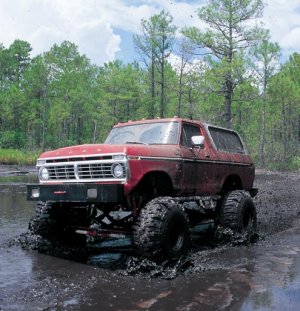

I like the round myself. I found this photo of a '79 where someone changed the front grill to the earlier grill and all I love the look!!
can we see the grill on the one you posted??
This black one is mine, it has the normal early 78 bronco grill and round lights. That red one is the look I was thinking about doing to mine.

Your 78 custom looks to be in remarkable shape! It is somewhat of a rarity having the rounds anyway as Bronco bill stated they only did a half year like that on the customs/ranger models. I do like the uniqueness of the older split grill look too. For prosperity sake you might consider leaving it stock. I guess it is a matter of taste.
Please, if you do put the '73 grill on send us some photos! Heck, your Bronco looks so nice send us some anyway! Since it is on a trailer I will just come get it if you want me to! I will send you some pics!!
