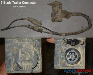

Isn't your trailer connector keyed?
How can you connect it properly, and upside down?
Something is wrong there.
EDIT: Mine looks like this

how many pins in your connector?
Is it Ford original equipt that came w/a trailer tow option?
Wiring Diagrams, Haynes for 87-89 Bronco & F series

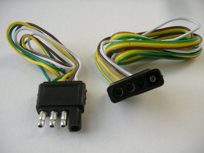

It is a factory plug altho I have a uhaul hitch? Anywho the factory plug is built into the rear bumper.
It's a round plug that plugs into the bumper..you can squeeze it in upside down..weird lol

Mine is built into the bumper (left of license plate). Altho my hitch is a uhaul hitch..dunno if it was upgraded or what. I know we had a hitch (or maybe bumper towed?) on it back when I was a young buck..we had a boat in Vancouver and used the Bronco to tow it with..this was back in 90 (truck is an 89). Uhaul hitch sticker doesn't look 20yrs old.. so it has to be an upgraded newer one..
I removed some of the surface rust, and painted it silver..lots of craters tho. It is stamped "FORD" though. It's a four pin.
