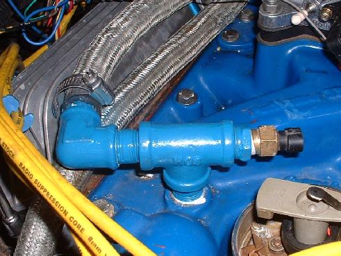

yo!
Try and get that from a dealer...slim to none; these thAngs are the type that prob wasn't even stocked by regional warehouses back in-da day; so..see what a dude (bottlefed70) did on his 302
this is a vg diy example! just add another t; or to get it to fit in that tight space, maybe insert a 90 w/hose barb & hose in there and get it to run where you have more room to make up a little manifold w/right size ******* and a female threaded piece for da sensor.
