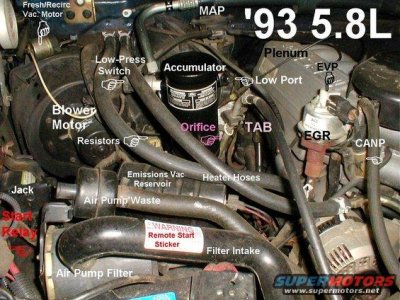

That is one sweet looking Bronco. I'd be all over that if I were you. Thats a smokin price too. The only spot I can see that you might be talking about for the missing vaccum hose unless I am missing it, that is the intake for your thermactor pump, its supposed to be open. Good find!!!
I was wondering what this was for. I noted that sometimes, but not always, it pushes air out of there. I thought that perhaps it was suppossed to go to the cat, and was disconencted.
So... what is this? And if air comes out of it, is that normal?
yo Joe, that is called the Secondary Air Silencer (Filter, or waste )
here is a pic by Steve;

I was wondering what this was for. I noted that sometimes, but not always, it pushes air out of there. I thought that perhaps it was suppossed to go to the cat, and was disconencted.So... what is this? And if air comes out of it, is that normal?
good question joe... mine is the same way.. i dunno what its for. all i know is i think it gets water in it when i go through big holes... lol i dont thin it is supposed to.. maybe i should hook up a hose and run it into the truck somewhere... lol...

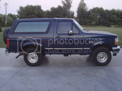

Well I picked it up today. Barely drove it though as I trailered it back. The engine sounds very good and the undercarriage is dry. It sure does need lots of cleaning. BTW does anyone have a picture of how the tension rod is placed for the rear seat?
So far things that need fixing are passenger window, won't go up, and rear window. I knew this in advance though, and oh yeah the dash is not as tight as it should be. I'll post more later. For now here is a pic in my driveway.
"The Air Injection (AIR) Pump receives air from a remote silencer filter. The clean air is then delivered under pressure and is either directed to the exhaust system or diverted into the atmosphere." I would say this is where that waste air is dumped into the atmosphere. The canister on the end helps even out the noise so it doesn't go "whump" "whump" "whump" in rythmn with the pump. If you are frequently getting water in it, I would make some kind of modification so you don't have to replace a $500+ air pump. Or you could disable it like other people, but since Congress has suddenly decided Al Gore is a national hero, emissions testing will be in all 50 states pretty soon.
