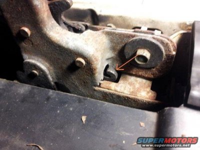

Here's the hood latch stuck in. This causes the issue your having because it got latched while the hood was up, whether you were climbing in and out or it got bumped. It gives you no warning until the hood doesn't close completely THEN IT'S LOCKED.

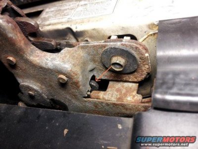

Here is what it should look like before the hood is closed. You'll see that it's pulled out.
What I've done since I've had this issue, I've put a wire in the latch where I can reach in and pull it to release it instead of trying to wiggle a pick to pull it. I WILL NOT have this issue NO MORE.
