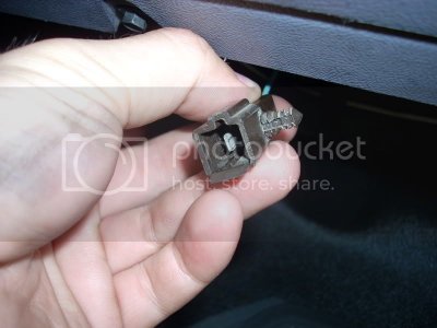

Locate the dealer mode programming enable single-terminal connector. The connector is located at the bottom of the instrument panel below the center of the glove box. On all vehicles, the dealer mode enable wire is Circuit #567 (LB/Y).
- here is the PSOM connector from under the dash, notice the flat pin in the connector, pic by jslax
Insert metal clip in service wire panel connector. Clip other end to vehicle ground while the key is in the OFF position.
