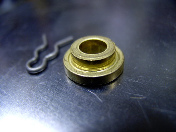

TV Brass Bushing "...are known to have problems with TV cable adjustment, and it's often due to the original rubber bushing cracking & falling out while driving, which normally destroys the transmission in a couple of miles. But it's so common that Ford makes this upgraded brass bushing (see pic for Ford part number), which is cheap (~$10) & easy to install..." Source: by Steve
TV Brass Bushing Info & pic; "...Part # F3SZ-7H303-B..." Source: by Sixlitre

Then confirm that you have an AOD. If so, do the bushing inspection first...and make sure TV cable and brackets are in-place then either do the TV adjusmt. w/pressure gauge or take it to a local shop w/good rep; I advise friends to use a tranny shop where Police/Fire Dept takes their vehicles.
