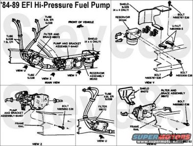

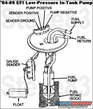

hellow fellows,i need to know how manny fuel lines com out from the tank, and where they go, please some photos,thanks jose :)>-
Well, first we need to know what year truck you have? In most tanks there is a vent line and a fuel line. The vent line goes to the engine compartment on the right side to a carbon canister. The fuel line comes out of the tank at the sender and goes to the engine on the left side. If you have an EFI engine there is a supply output at the sender and a return pipe at the sender. The information in the Bronco Graveyard catalog may he[ you sort it out http://broncograveyard.com/bronco/c-95
yo,
Jose has a "bronco 1988, 302"
I'll post the pic in full view instead of thumbnail in case Jose doesn't know how to enlarge it here.
Low-Pressure In-Tank Fuel Pump for 84-89 EFIs
by Ford via Steve83
Pump, Filter, & Single-Function Reservoir Parts Break-Out Diagram in 84-89
by Ford via Steve83
@ http://content.chiltonsonline.com/content/images/8492/images/84925028.pdf
89 5.0 Fuel Line ID and Diagram by Chilton
Shows SUPPLY TUBE on Driver's side to Filter/Single-Function Reservoir & then on to Fuel Pressure Regulator - Injectors
& Evaporator Tube on Passenger side
