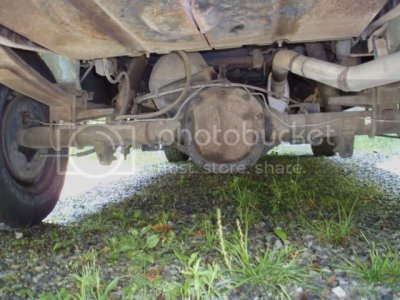

here was the setup i made for my truck for $30. summit gave me $25 free so the true price was about $55. i purchased two 3bolt flanges, welded one on the truck just after the cat and then worked my way back.
one thing i did was get a center in/offset out muffler so i could mount it sideways and tuck it up a little more. if you do something like this you just have to make sure you have a small hole at the bottom for condensation to drain
its been on the truck for 3 years now. its got a little tone inside the truck but from outside i was told it sounds nice and deep(this is a 6cylinder).

i just dug up another pic of the exhaust where it hops the axle

just keep in mind how low it will have to be to clear the frame in that area. unless you cut the body and jump over the frame.
