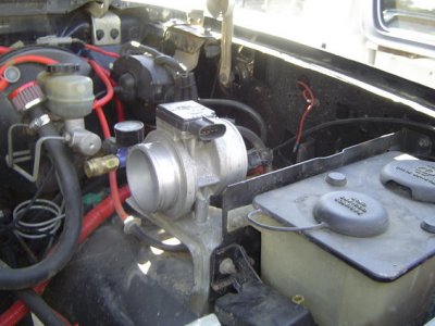

Ok so I was looking into what ya'll said and here is what I found. There is a air leak. I am hoping that is the problem and not the Mass Airflow Sensor. But thing is I dont know what this is....... In the pic you will notice an air line that joins...what I will call a T junction.....but only exits on one branch of it. The other exit is open. there was a plug on it with no apparent purpose. That plug had a crack in it and was allowing air to be pulled into it. It is a Vacuum line. I wouild LOVE to know what the purpose is, maybe originally there was something else that it went to???
If it was capped off with a vacuum cap, replace it. It looks like someone used a T in place of an L fitting for the tight fit there rather than running the hose direct. The whistle would definitely come from a vacuum leak and that will also give a check engine light because it messes up the MAF readings.

as Seabronco wrote; someone changed the vac. line or cut it and swapped in da angle fitting; here is your underhood vac diagram from Ford; it shows just that single vac. line from throttle body to vapor management valve
checked my 96 5.0; has that single vac line from TB to the vapor management valve; hose is pre-formed bent rubber line transitioning to a typical Ford plastic line going to the VMV.
