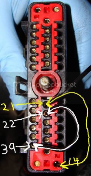

My 96's 4WABS Module's microprocessors burnt-out and 2 yard Modules were also bad; so I removed the 4WABS Bulb & jumpered the Module out as Turbo Ghost describes below.
"To bypass the 4WABS module @ it's harness's connector & feed the 4WABS signal directly to the PSOM,
Disconnect module (under coolant recovery /ws washer tank) & in connector, jumper LG/Bk to LG/Y, and R/Pk to O/LB..."
Notice orientation of the connector pins.
4WABS Control Module Removal in 93-96; "...Disconnect the plug from it, remove the 10mm bolt holding it in and slide it out of the keyway" (see lower image)
Source: by Froggmann (Ken P)
I unwrapped harness covering to expose the wires and cut the four wires 4 inches away from the coonector and spliced wires shown in turboghost's pic.
I used weather resistant in-line (butt) crimp connectors. Covered connector with a surgical glove , leaving small opening facing down.
Tied connector to radidtor's neck.
