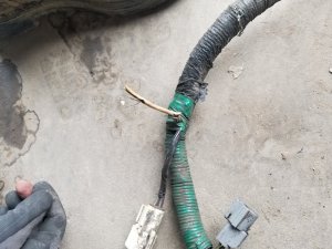

So the new harness arrived and has one wire cut, its towards the tailgate plugs, its white and really stiff not sure what it goes to

You can unplug the wire off the reverse sending unit --and check to see if its getting power. You will have to have the switch on to check it. and make sure the wheels is chaulked or emergecy brake is set. Before you crawl under it..I

You can unplug the wire off the reverse sending unit --and check to see if its getting power. You will have to have the switch on to check it. and make sure the wheels is chaulked or emergecy brake is set. Before you crawl under it.. Driving through brush,muddy water and mud cause,s more problems and cost alot of money . Don,t do it and you,ll have less problems.
