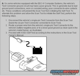

Scan Tool Won't Initiate Self-Tests; malfunctioning Electronic Engine Control (EEC) Relay in a 92; Jeremy wrote on Page 2; "...I was able to get codes the old fashioned way by counting the flashes on dashboard, so I think that would eliminate any prospect of it being something in the wiring; ....As luck would have, it appears that changing out the old EEC relay did the trick. At first I didn't think it would. Instead of using wire from the self test connector to the battery, I plugged it directly into the connector on the tool and went through the KOEO code retreival process and lo and behold I got codes..I even got the KOER test to work as well..."; miesk5 Note; If the CEL is burned out, connect CEL © to a 12V test light, and the light's other terminal to a 12V source on the same vehicle..."
Or quicker, show this to the mechanics;
Can run a wire like that in this self test:
