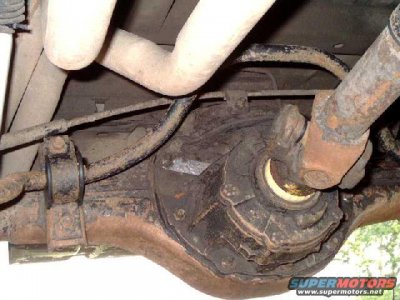

I didn't even know I had an ID tag until I cleaned all of the mud off of my axles. Like Gunner said, I had 20 years of grease, grime, sludge, mud built up on the diff.
This is a pic of the ID tag, it's the silver strip on the center carrier for the 9":

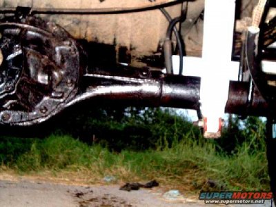

While I was hunting up that pic I found this one. Same axle, about five minutes after applying Restore rust preventer. I came back later with another coat the next day, to get it more blakc.
