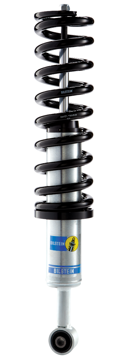

Problem: 78 Bronco leans a bit left to right in the rear and when the rear flexes while driving it gives me a bit of tail waggle because of the Deaver spring flex. Want advice on stiffening the rear and thought a set of ride height adjustable coil over shocks would be a good idea. There are so so many options out there but I am still having trouble finding some that would work in this application. Was hoping for Bilstein's b8-5100 42mm or b8-6112s 60mm but I cannot figure out how they would mount. Eye to Eye in the rear. Open to other ideas and brands. Trying to keep cost reasonable.
Questions:
Which to go with 42mm or 60mm?
How would I mount these at the top or convert from the eye to eye setup?
Or could I get any shock and add a coil to it by modifying the shock itself?
Ride details: JBG Deavers for all springs - coil front - leaf rear. Made drop brackets so I could keep the sway bar. Adjustable track bar on the front. 37's x 12 Tires. Quad Bilsteins shocks on the front (love these).
