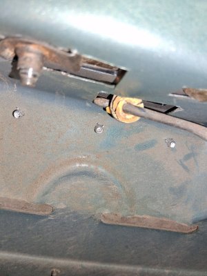

Well the sheet metal in my drivers door gave out where the bolt retainer clip is. I bought and installed the Bronco Graveyard Inside Door Handle Reinforcement Plate.
I aligned it identically to the cutouts in the door panel and riveted in place.
Installed the rod and bolted the actuator mechanism in place. It is solid.
However, it is not opening the door unless I push the Rod just slightly. What would you do? Replace just interior door opening mechanism? Replace that and rod? Or?
Thanks in advance for sharing your experience/expertise.

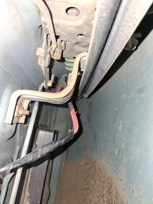

Unfortunately, the rod in my 1988 is not threaded. Both ends are bent with the plastic yellow bushings securing the rod. Any other experience you can share?
1,174
1,242
I would see if there is room to move the handle forward.
We used to bend the linkage between the handle and latch. It didn't last forever but worked great for a while.
It sounds like something is bent just a little.

Thanks, loosen the bolts and move the handle back towards the latch as far as the bolt holes will allow, and make sure none of the bends in the rod are exaggerated. (Could be tolerance stack up stopping the travel a tiny bit early)
You can gain some lenght by straightening a factory bend in the rod a bit.

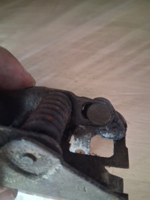

I got it working! The issue turned out to be the lever mechanism in the door.
Not the greatest pic, but the rivet is on the shift lever that attaches to the rod (other end to the rod) oblonged the metal that actuates the open function. I bought a new interior door lever and plastic gromet from Bronco Graveyard and can now exit my truck from the inside! No more winding down the window to get out!
