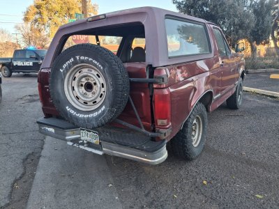

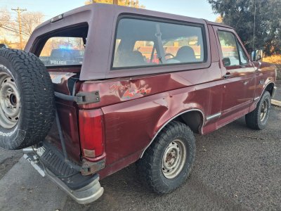

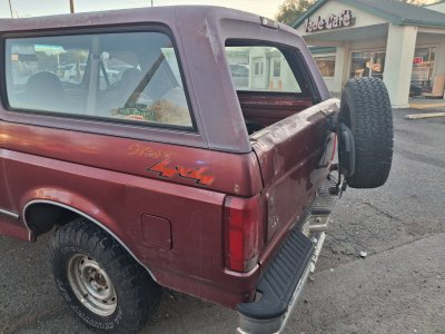

I own a '96 that I love. His name is Slayer and we have been over many a pass together. He was struck (interesting story) in a way that pretty much ruined him for closing the gate. I can buy a 91 here in my home town which is minus the 351 (I have a 302). The easy (!) way would be to transplant my 302 into the 91. It even has power windows and buckets and a straight rust free body.
To pull the doors, buckets, wiring, plus 1/4 panel and tailgate would be a lot of work. But it has identity. Plus the value of the last year it was made is worth something? Maybe?
See how he even bent the spare rack? He hit right on the spare hard enough that it spun the parked Bronco 45 degrees! I love Slayer and don't wanna get rid of him but I can't close the back up and it's cold out there.

Hey there cobronco, that was a hard hit for sure, not sure if it tweaked the frame. (Hit high on the spare) the 1/4 panel and tailgate might have taken the brunt.
If you can live with the wrinkles, try bolting on the tailgate from the 91 (it will fit)
If it will close, you are in business.
The 96 is OBD11 and the 91 is OBD1
Not much is the same in the engine controls. It will be more work to re-wire the 91 to accept the 302 than the bodywork.
The 96 is way more truck all the way around. If the frames not bent, Id go the try and fix it route.

Thanks. How can I check the frame for sure? I got this from a dealer that had cleaned it up, no history. I has always driven squirrely and I can't get anyone to take it seriously. No one will just measure the frame and tell me. They want me to pay for alignment and then wait until they cant straighten it to determine the frame is bad. (!)
Interestingly it's drivability actually improved from this accident. Maybe "corrected" a previous damage? Seems that if you pull the frame and running gear across the asphalt sideways by pulling on the body, it would likely twist the body right off the frame. The body shops scoff at my concerns.

Frames are tough to measure with the body on. The frame shops used to have gauges they hung on the frame at specific spots (called datum points)
Now they have a computerized rig that sits under the truck and an arm is placed at each of the datum points so see if the frame is swayed, twisted or diamond. Look really closely at the frame, especially in the rear, look for spots near crossmembers where the dirt is flaked off or there is “fresh” surface rust, this usually indicates bends. Its not very accurate though.
The best way honestly is at a frame shop.
Wish I could be more help, sorry.
