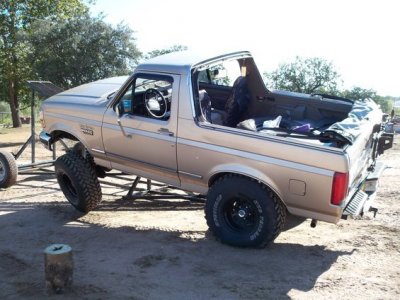

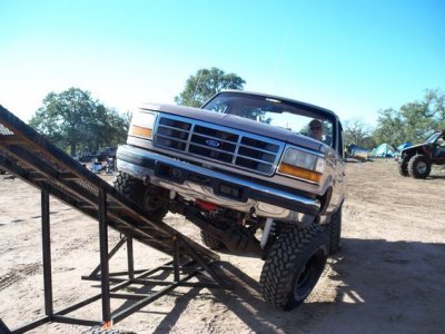

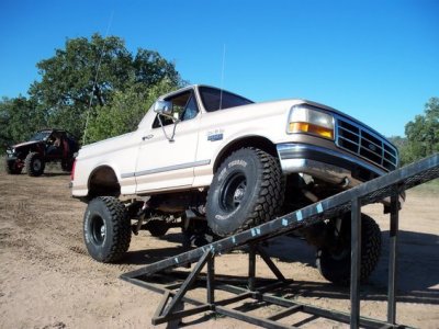

Here are a few pictures of my truck (6" inch lift, extended radius arms) on an RTI ramp and some video of its wheel travel.

JSM84 makes a good point about the tire size. The bigger, the better for rock crawling. But I did this (see video) with just 35 inch tires.
It probably wouln't have snapped if the front was not locked, but then without the locker, I wouldn't have made it to point where it broke. Catch 22 :p /emoticons/[email protected] 2x" width="20" height="20" />
