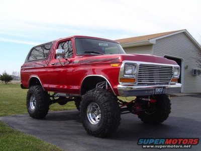

I have a 9" inch suspension lift on mine and I run 38.5 Swamper's.
