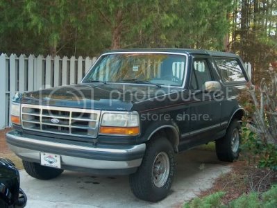

Welcome to broncozone! Hey, in the first pic, I can see some oil under it, check for oil leaks (Broncos are famous for leaks) I think you mean the enigne is a 302, not 305. The truck is really clean!

A 305 is a Chevy motor used in 1/2 ton pickup trucks and Camaros in the late 80's. If you pulled the engine out of a mustang, it's a 302. Trust us. It could be the stock engine too. Broncos come with 302's and 351's. Judging from the location of the oil puddles under your vehicle, it looks like you have the exact same problem I had. Your oil pan gasket is shot. The oil is leaking out the back side of the pan, down onto the crossmember and it is dripping to the ground from ten different spots. On any two wheel drive, it's an easy fix. But on a Bronco, it's not so easy. I just replaced mine about three weeks ago. It involves removing the intake manifold, pulling the motor mounts and lifting the engine up about six to eight inches. Only then will you have enough clearance to fanagle the pan out from above the crossmember. It seems as though this is a chronic problem with many Broncos. Once you get the bronco and you're ready to fix it, PM me and I'll give you specific instructions.
