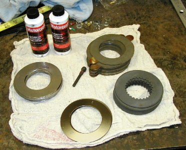

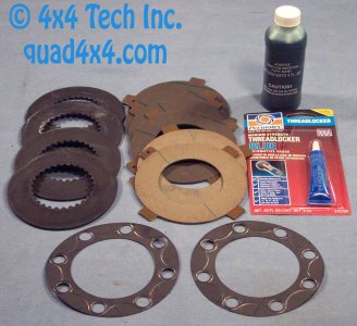

seeing the animation might help see how the clutches work. The clutches include friction plates and steel plates. They are sandwiched behind the small planetary gear that connects to each axle in that center housing. Some of the clutches are splines to the axle, some to the housing. This lets the housing rotate without the axle rotating with it. So basically if one wheel starts turning a lot faster than the other wheel the friction in the clutches grabs the housing and rotates the housing. So the clutches on the driven wheel grab since they are free spinning and turn the housing which makes the clutches on the other "free" axle grab and spin that axle to help out with traction. Its a very simple idea and it used in a lot of different ways. AWD cars use clutches in the front/rear and center to limit slip between all 4 wheels. Could be friction plates like in my quadradrive jeep, could be a viscous clutch like a torque convertor, could be electro mechanical like in a wrx.
you can see the metal plates have teeth on the inside and the friction plates dont, they have the big "ears"
