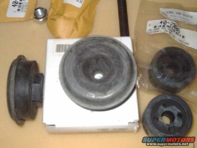

are you referring to the radiator core support mount? You can get the bushing and hardware (including a new bolt) from JBG or LMC Truck, JSM84

Yes, Fastenal Co. is a good source for bolts, too. The pic I posted of the core support bushings and hardware is from LMC Truck. A good thing about them is the part numbers are the same as Ford, and match up to any parts diagrams for those items. The box even has "FoMoCo" printed on it, so it's an original or OEM part. Only problem is the 80-86 Bronco parts shown do not fit my 84 Bronco. I must have some older 78/79 style core support bushings from the factory. JSM84

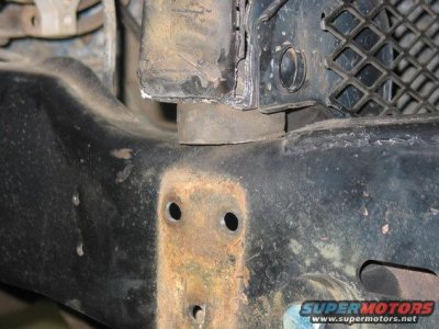

Ok so I took a picture of what i have left maybe you guys can tell what im talking about. Form as far as I can tell I would have to say yes to "JSM" on them being core supports. but they dont really look like the pics that JSM posted here. So I'll post mine and you guys tell me if it is the correct part...
I couldnt find the rubber that goes in between and as you already know the top part broke..

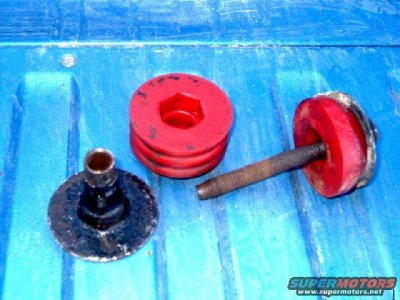

Here's a pic of mine, looks to be the same type. The bushing has an index for the hex shape inside the metal sleeve. I had to cut off the old rubber, and then cut the sleeve in half to remove it. The red bushings are poly's from Daystar, and you can see they're much different than the FoMoCo OEM ones from LMC truck.
You have a couple choices. Since that long bolt threads into the metal sleeve, it shouldn't be re-used if the threads are galled, stripped or rusty like mine in the pic. You can try using grease, anit-seize or paint. but you'll end up having to cut it apart one day again. My solution is to re-locate the body mount to the top of the frame, similar to the body mounts under the cargo area in the rear. Then you can use a regular body mount bushing and bolt through the frame. This gives you a bit more tire clearance up front by removing the outboard mounts on the frame.

Ok so the ones from lmc dont look quit like mine will they work? I dont wanna use any of the old parts i would like to buy new ones for both sides.
I just dont know if the ones in the catolog will work with my application. The picture doesnt show the flat sleeve just a nut, bolt, bushings, and washers....
Is this the right one or is it just the equivalent????
The new bushings and hardware from LMC Truck will NOT work in our case. The newer one is shorter by almost an inch, and the hex shape on the bottom of the rubber doesn't fit the round hole in our frame bracket. You cannot buy new ones for our style, I've been trying for two years to find them. Every place that sells them shows the newer style from LMC Truck in the first pic. The ones you and I have must be leftover parts from another application. You could make your own, as I thought of doing. A spring eye bushing sleeve or similar size metal tube, welded onto a flat washer, then threaded for the long bolt.
Much easier to re-locate to the top of the frame. You will need to drill a hole for the regular body bushing to fit into, which is about 1-1/4" diameter. Use a torch to cut the hole, then weld a flat washer on top the right size. Drill a bolt hole through the core support, and add a metal plate for support. I had to do something like that one my tranny crossmember for the oddball bushings there, too.
Here's a pic of the re-located core support mount on an 81 Bronco:

Ok so forgive me for my ignorance... I understand that the oem replacement from lmc wont work with out modification.. But the polys that you showed me further up... What about that do they sell that kit? If so I tried to look up Daystar and got some effing religous site to donate money. LoL I dont think that was exactly what I wanted....
But yeah
The red poly bushings I show in the #2 pic are made by Daystar. I got them in a master body and suspension bushing kit from Daystar, which I bought from Rocky Mountain Suspension. The kit only includes the poly bushings, not the metal sleeves or hardware. You might not be able to tell on your Bronco since the rubber part of the bushing rotted away or fell off, but the original bushing came as an assembly, with the rubber molded onto the metal sleeve portion. So, the core support bushing is different from the rest of the body mounts, which have the metal and the rubber as separate items. While mine were still intact, the rubber was cracked and dry-rotted, and the bolt threads were galled up so bad I couldn't remove it without cutting. The only way to use the style shown in the #1 pic from LMC Truck is to swa pout the bracket for the mount, which is riveted to the frame. Every vendor that I've checked with only has the LMC-style bushing assembly, because that is what the Ford parts diagram shows you have in the 80-86 Bronco/F-150. I know for a fact that mine on the 84 are factory original, since I'm the second owner and know the original owner from before the time he bought it new in 1984. Getting back to the Daystar poly kit, which does have the correct bushing. It had parts for 80-96 Bronco, F-150, Ranger, Explorer and the Navajo. So it had lots of extra parts besides what was needed fo my Bronco. But i have yet to find out what vehicle my 84 core supportr bushings actually came from. Only someone asssembling the Bronco at the time would know. It cannot be the Ranger, or Explorer since those came out after 1986. JSM84

Just to update: Roadkill and I did the bushing mod on top of the 84 Bronco frame yesterday. It was very easy. I used the smaller, lower bushing from LMC Truck (pt #40-2006), which is a rubber bushing with a metal washer impregnated on top. While I used the factory 5" bolt and locking nut, I think I'll replace that with a shorter (2-1/2" long) standard 7/16" bolt and SAE nut to hold the bushing in place. JSM84
