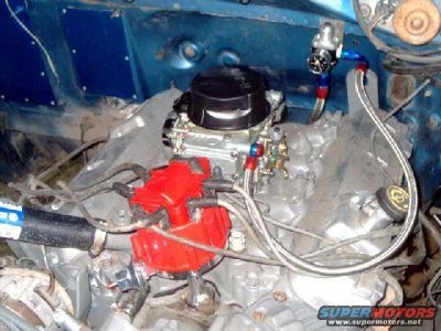

Think I have a pic of my HVAC removal:
I covered the holes in the fierwall with sheetmetal, and painted it with a blue color close to the original. There are two separate holes in the firewall, but I believe the fan cage and AC evaporator are contained in one unit (far left in pic/ closest to the fender). I don't ever need the heater down here in S. TX, so it was much easier to just bypass the system. There is now alot more room for that 460, JSM84

JSM, thats the picture I remember seeing, looks good
