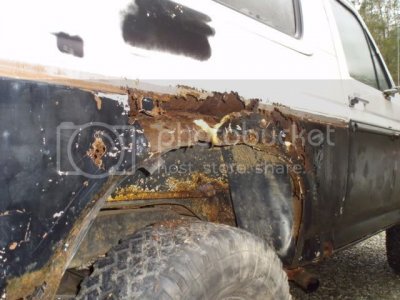

Myself and my father in law will be doing the work. There are some different options out there! Thanks for the tips. most of my rusting is right around the wheel wells and near the bottom of the fenders, its not too bad yet down there but would like to get it taken care of. I'll see if I can get some pics posted up.
M
metz33
Apr 14, 2008
Here are some pics for you to look over and make suggestions if you would like. Thanks again.
shift1313
Mar 16, 2008
647
VA
thats nothing! you probably dont even need to buy and pieces, just go get yourself 16 or 18ga sheet from lowes and some tin snips. Strip the paint away and cut the smallest section out you can. i doubt you will even have to form the metal. Just make your piece just under the surface of the body and use body filler to get the contour back.
