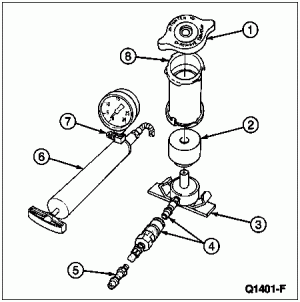

Radiator Cap Pressure Test
  1. Remove the radiator cap from the radiator filler neck.
  1. Use water to clean the radiator cap in the area of the rubber seal and the vacuum relief valve as described in Radiator Cap in the Cleaning and Inspection portion of this section. Immerse the radiator cap in water to wet the seals and install on the shallow filler neck of Rotunda Radiator/Heater Core Pressure Tester Adapter 021-00013 or equivalent. (The adapter is designed to accept both deep and shallow neck radiator caps.)
  1. Before installing the radiator cap on the adapter, immerse the filler neck seal in water and install it in the filler neck adapter. If the adapter is made of plastic, check its sealing surfaces to be certain that they are free of rough spots and contain no parting lines or core marks.
    The filler neck seal is reversible so that it may be used on either a deep or shallow radiator filler neck. It will also fit either end of the radiator cap pressure test adapter.
  1. Install the filler neck adapter with filler neck seal on the deep filler neck end to the radiator cap pressure test adapter.
  1. Connect the female quick disconnect fitting of the pressure test pump to the male quick disconnect fitting of the filler neck adapter.
    ItemPart NumberDescription
    18100Radiator Cap
    2Filler Neck Seal
    (Part of 107-01301)
    3Filler Neck Adapter
    (Part of 107-01301)
    4Quick Disconnect Fittings
    (Part of 107-01301)
    5Temperature Sender Pressure Hose Adapter
    (Part of 107-01301)
    6Pressure Test Pump 021-00013 or Equivalent (Part of 107-01301)
    7Pressure Relief Screw
    (Part of 107-01301)
    8Radiator Cap Pressure Test Adapter (Part of 107-01301)
  1. SLOWLY depress the pump plunger of the pressure test pump until the pressure gauge reading stops increasing and note the highest pressure reading obtained. If the plunger of the pump is depressed too fast, an erroneous pressure reading will result.
  1. Release the pressure by depressing the pressure relief valve stem. Then, tighten the pressure relief screw and repeat Step 6 (at least twice) to make sure the pressure test reading is repeatable within the acceptable gauge reading limits of the radiator cap and is not erratic. Refer to Specifications at end of this section.
  1. If the pressure test gauge readings are not within the acceptable gauge reading limits, replace the radiator cap, and perform the pressure test. If the pressure test gauge readings are within the acceptable gauge reading limits, perform the pressure test.
