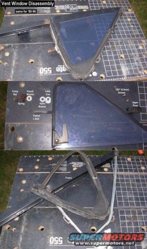

I am not sure about what type of adhesive to use but the vent window is removed buy rolling down the door glass and there are 3 or 4 screws that hold it to the window frame on the outside of it where the door closes against the windshield frame the screws should be under your old weatherstrip when you take out these screws it will allow you to pry it out of the door frame along with the window track on that side.When applying new weatherstrip, what type if any adhesive should be used, and how is the vent window glass and hinge removed to apply new weatherstrip? Thanks!
