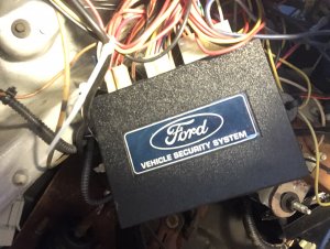

Do you have a chipped key? Or do you have a remote?
93 shouldn't be a pats system. That is a picture of an add on. If you think it is causing issues just unplug the connectors.

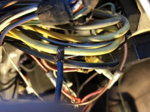

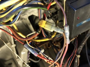

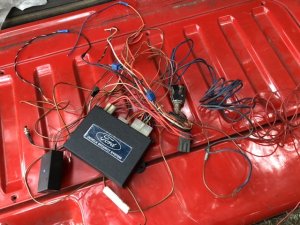

No chip and no remotes but if you unplug it truck doesn’t start, no spin, nothing. Did that when I first got it😎. Why can’t I get any codes? Guess I’ll go today & start seeing if I can remove it? And pull the inner fender and take a look at the PCM.

You can't get any codes because every time the battery goes dead the codes are erased.
