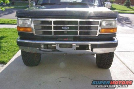

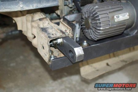

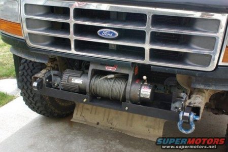

Not sure what year you have. But this was my solution on my 95
I was planning on putting the bumper back on
But have gotten used to it like this. Much better approach angle.
I think it would take one **** of a stuck to twist the frame.

well i have a 96 but im thinking of doing a setup similar to that with the angle iron but im thinking of puttin the hooks on the bottom of the angle iron... so many choices im just out for looks and performance....you ever had any problems with the air bags by having them shackles on the c-zone?

They are bolted in front of the crumple zone. I try not to need the airbag (only 1 in the Bronco), but with where everything is bolted should not be an issue, I hope.

Nope just a 1"X2"X12" chunk of steel cut in half and drilled. If I had to make new ones I would get them a bit longer they do not stick out in front of the bumper enough. It would be better with 14-16" with the extra stuck into the frame further.
