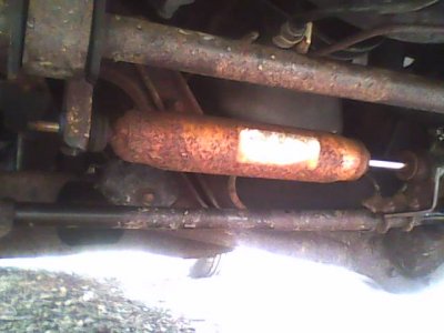

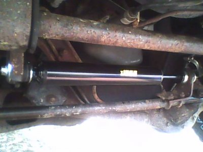

Heres a Monroe installed on my 93 Bronco XLT that had the factory mounts on it (see frame mount hanging down on the left).. took very little time to do.. and seemed to help..
The old one was VERY shot looking..
